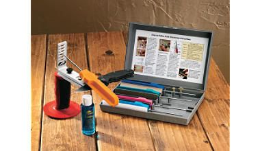

  • breamfisherbreamfisher Posts: 14,104 Senior Member
    Lansky or Gatco knife sharpener where you clamp the knife into a sharpening guide is one.
    Meh.
  • jbp-ohiojbp-ohio Posts: 10,940 Senior Member
    Me either.... I use a Lansky sharpener. It keeps a constant angle, but it is still time consuming. Stiil need to strop. Leather would be better, but cardboard will do...
    Thought about one of the fancy Chef eletric sharpeners...

    I've got several different sharpeners and they have different applications. With my hunting knives and my nicer pocket knives I use a Lansky. If you have good concentration and a steady hand you can do as well with just a stone but with a Lansky, just about anyone could turn a butter knife into a scalpel with little effort.
    :that: Get the one that comes with the diamond stones, it works better for your harder steels.
    Avoid those motor driven sharpers like the STDs. They will destroy a good hunting knife in a heart beat.
    For my Leathermans and the like that I really have diffacult time using the Lansky system, I use the sharpeners that have two ceramic rods placed in a "V" and you just drive the blade across to sharpen.

    I use a Chef's Choice for all of my kitchen knives and it works great for that purpose. My pocket and carry knives get tuned up on some sort of version of the Lansky.

    i got one of the Lanskys sharpeners and they work fine. as long as you dont have a long blade that is or you need to move the clamping mechanism.

    I use a Gatco kit. It gets them razor sharp.

    I, too, use the Lansky sytem. Works great and hadly requires any thought.

    I am of the opinion that every man ought to know how to put a razor edge on a knife. I read and learned and can. I'm also lazy, and like the Lansky croc stix a lot. 4 stick system, really works. It won't do as well as a diamond stone followed by ceramic followed by a strop and compound,, but in 45 seconds, ya get 90% as good a job with far less potential drama.

    The Lansky's are good. You might also look at Spyderco's Tri-Angle. Not quite as sophisticated and lacking the variability of the Lansky, but faster. All you have to be able to do is hold the blade straight up and down.
