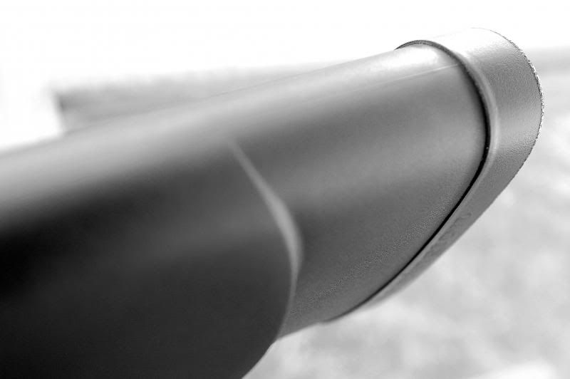

I will be ditching the factory stock and it's short length of pull (even for a Carney), crappy fit/finish, zero bedding, and barrel pressure point. By the way, I figure if I'm going to hack on Savage for the cruddy fit/finish on their stock...............might as well ding Remington for the same thing while I'm at it.
Pathetic!
I am actually going to try a Choate stock with aluminum V-Block for this rifle.

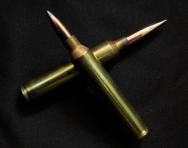

Anyway, back at the ranch with a fired case.............I was trying to measure the ogive length to lands with a 162gr A-Max. Unfortunately, Remington puts 10mm of freebore in the 7mm Ultra Mag to reduce pressure. Unfortunately, this is not conducive to accuracy with shorter bullets. Unfortunately again, with the excessive freebore, I can't even touch the lands with the 162gr A-Max!!!!!
139gr SST / 162gr SST / 162gr A-Max (seated long)
Therefore, I will also be trying the 180gr Berger Hunting VLD in this rifle. Trying to get closer to the lands with the longer bullet. But, still unable to touch them!!!
160gr Partition / 180gr Berger
I will test the accuracy of the A-Max and Berger.......
.........and use the winner to make 100 rounds of ammunition (found a deal on 40 new cases as well). The other 100 or so will be the 139gr SST and 160gr Partition.
