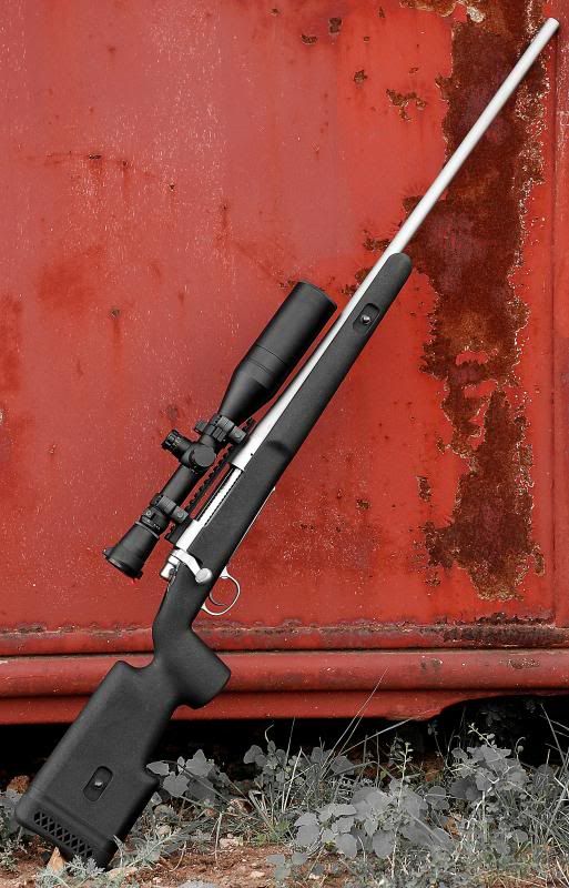

I got "The Sister" awhile back, as you might remember. I've been waiting for a gifted stock to arrive before any real range work. Well, it finally did.
Choate Tactical
It's a beast of a stock with a full length aluminum bedding block surrounded by 80/20 polypropylene/fiberglass, a forend rail system, and 4 QD sling studs. Don't know the weight of the actual stock, but the shipping was 6 pounds and the rifle set up as so weighs 12 pounds with a sporter barrel. It's a haus!

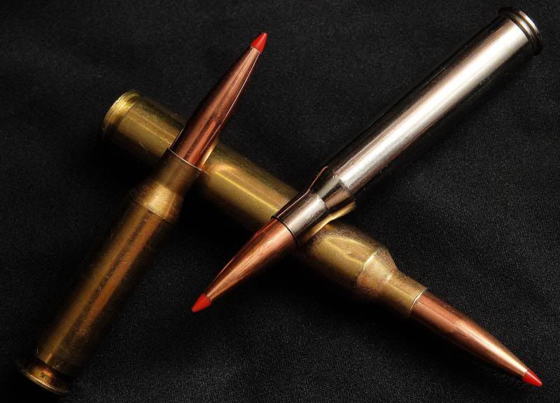

I was unable to find any load data using Retumbo and 162gr A-Max bullets, so I went off Hodgdon data for the 162gr Hornady PSPBT. Max load listed was 95gr of Retumbo. So, I started at 94gr and went up in .5 grain increments to 95.5 grains.
94gr / 94.5gr / 95gr / 95.5gr
Seating depth is somewhat of an issue with this chambering. As you might recall, Remington gives this chambering 10mm of freebore in an attempt to create a pressure chamber for the bullet. Well, I don't want that. So, seated out about as far as I can, I still can't touch the lands.
As you can see, only half the bearing surface is in contact with the case neck. Seated as such, I obviously can't use the rifles magazine. That is no big deal. Only issue is that I can't extract a loaded round without pulling the bolt out with the bolt release. Oh well.
At the range, the stock is rather comfortable and stable. The wide forend rides the front rest well.........
........and the cut out in the butt stock rides the rear bag. Very nice, actually.
It's a very LONG stock overall, which I like. With the adjustable length of pull, I was able to take a spacer out and make it a little mo betta for me.

    What is the purpose of this rifle?
    Seating the bullets half in the neck bearing surface seems counter intuitive. First, you have turned that gun into a single shot rifle, and second, how stable are those bullets in the casings when there is just half the neck to stabilize them? If the did fit in your magazine I am betting recoil might change their COAL.
