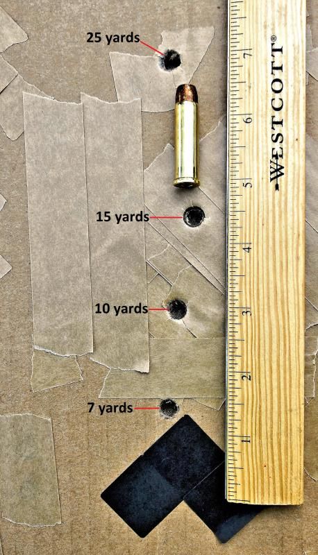

    Well, there is no zeroing the GP-100 with these loads. It is flat bottomed out. I will either have to aim low or get a different front sight. BUGGAR!!!!!
    Here is the progression of impact.

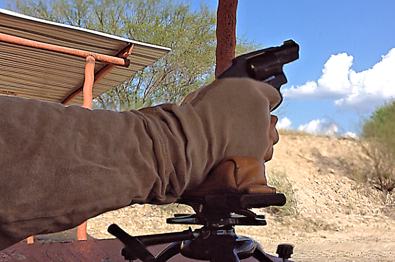

    Next, I tried the 180gr loads in my 340 M&P.
    HELLO!!!! ( 1st shot is a 110gr factory load / 2nd shot is a 180gr handload)
    th_IMG_3345_zps8c57611d.mp4
    That sucker's got some get up an GO!!! I tell you what.........that ain't no hand shake. Joker thumps your palm without a doubt.
    Here is a 110gr frame capture at max recoil for comparison.
    Effects of pre-bullet-exit muzzle climb?

  • ZeeZee Posts: 28,455 Senior Member
    JasonMPD wrote: »
    I guess.
    Well on the bright side you can only kill something "so" dead
    practicing for that 1000 yard steel shot ?
    Bullet is just too heavy and thus slow leaving the barrel
    Get some 158 gr and be able to hit where you aim

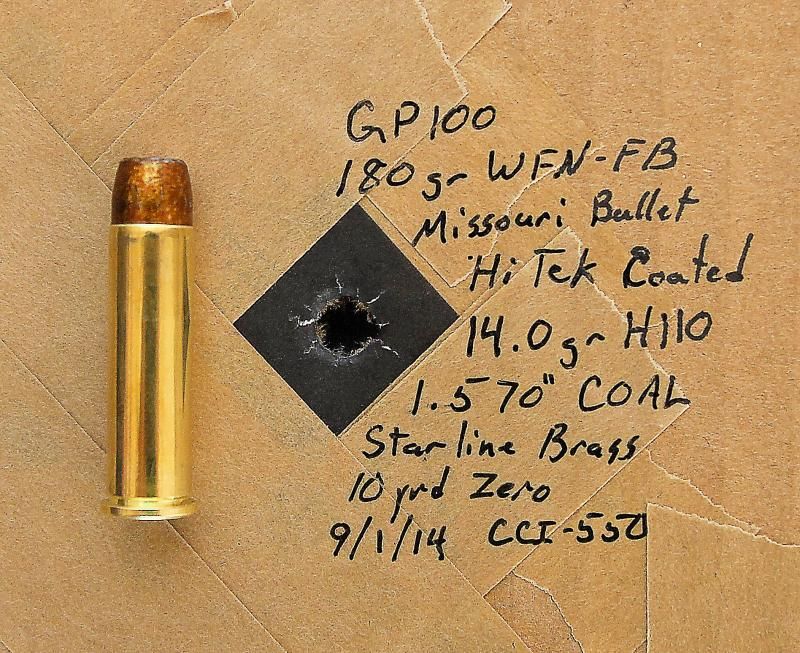

    Anyway, I adjusted the rear sight and sighted the gun in at 10 yards. Which, judging by the "string".........seemed like a happy medium.
    10 Yard Zero
    10 Yard Zero Confirmation

    I am apparently altering my POA according to the size of the target. I think I'm holding a tad lower (lollipop) on smaller targets and a tad higher (center) on larger targets. I don't know. But, either way...................I got it sighted in!!!!!!!!!!
    HAPPY!!!!
