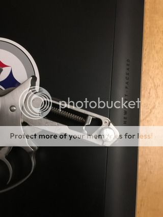

I ordered a set of Hogues to replace the grips on my GP100. They're not as comfortable as they are pretty. So, I removed the old ones, and got stuck on the locator lug:
I can't get that thing to budge. I tried tapping on it with a small hammer, and attempted to twist it using some channel-lock pliers (covered it first with a towel); it won't move at all. I've searched the interwebs to see if anyone else has had this issue, with no luck. The only thing I can figure is that the previous owner used something to stick it in place, but for the life of me I can't think of a single reason why anyone would do that.
Anyone got any ideas about what I can do?

    Drill and tap the lug for a 10-32 screw, and use a long screw, a nut and washer, and a sleeve like a socket wrench as a puller to take it out. A similar setup is used as a "stuck case remover" in a reloading die.

    Thanks Teach. I'm going to give it a shot. I don't have the tools myself, but I know someone who does.

    It's soft aluminum. Just drill a big hole thru the middle and then drive it out. New ones from brownells are about $2

    Before you move on to drills and the BFH there is a better than average chance the previous owner just used something silly like superglue to keep it in place. Get some acetone of steal the nail polish remover from your favorite female and soak the bottom of the grip for a few hours in it. Might do the trick.

    If it's stuck in with something like superglue, heat is your friend. Warm it up with a Propane torch for a minute or so and tap on it with a soft-faced hammer. You're not likely to get the grip frame hot enough to damage anything unless you get really stupid with the heat source. One side looks like it's peened and expanded already, so it might be a good idea to drive it out the other way.

    Finger nail polish bath didn't work. Gonna try heat next. If that doesn't work, out come the power tools.

    I would guess that the previous owner did not know that the piece should fit loosely and used something to hold it in place.

    Held a torch to it for a little while and tried to tap it out; nothing. It still won't budge. This is getting serious. Time for power tools!
    I wonder if you could drill a hole slightly larger than the lug in a scrap board. Sandwich the grip frame between that board and an undrilled board in a vise with the lug lined up in the hole and slowly tighten the jaws.

    Stubborn lug vs power tools............power tools win!! I drilled a hole in the lug and grabbed it with some vise grips. I twisted it with the grips and it started to turn. I then used a few different things to pound on it until it started moving. It took an hour and a half of pounding and twisting and WD-40 before I remembered what Teach said about one side being peened and expanded. I popped the punch in the other side and bam! It came right out.
    So, I put the Hogues on and did my happy dance.

    was it glued or what made it so tight? as other have said, the one i had just fell out.
    There was no visible residue of glue, but it did seem as if this piece was not OEM. It was so tight in there I can't think it was the original lug. I don't know what effect, if any, WD-40 has on glue, but it may be possible that the WD-40 removed the residue as the lug was being pushed out. :uhm:
