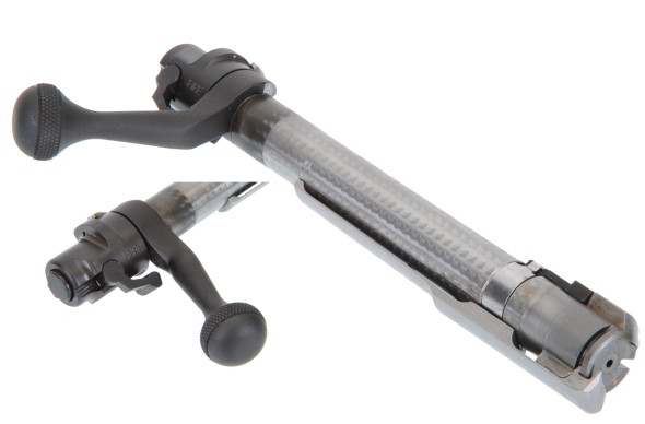

  • Big Al1Big Al1 Posts: 8,811 Senior Member
    Looks like a post '64 M70 push feed. There's a small lever at the back of the bolt, push it forward/down and it will release the bolt.
    See the source image
    Post 64.
    See the source imagePre '64
    The ammo looks corroded. That green stuff is bad juju, weakens the brass. New ammo should work fine!!

  • GunNutGunNut Posts: 7,642 Senior Member
    Post 64.
    Al is correct, push feed post 64.  I’ll go with corroded compromised brass too.
