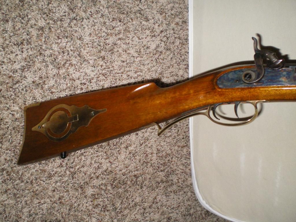

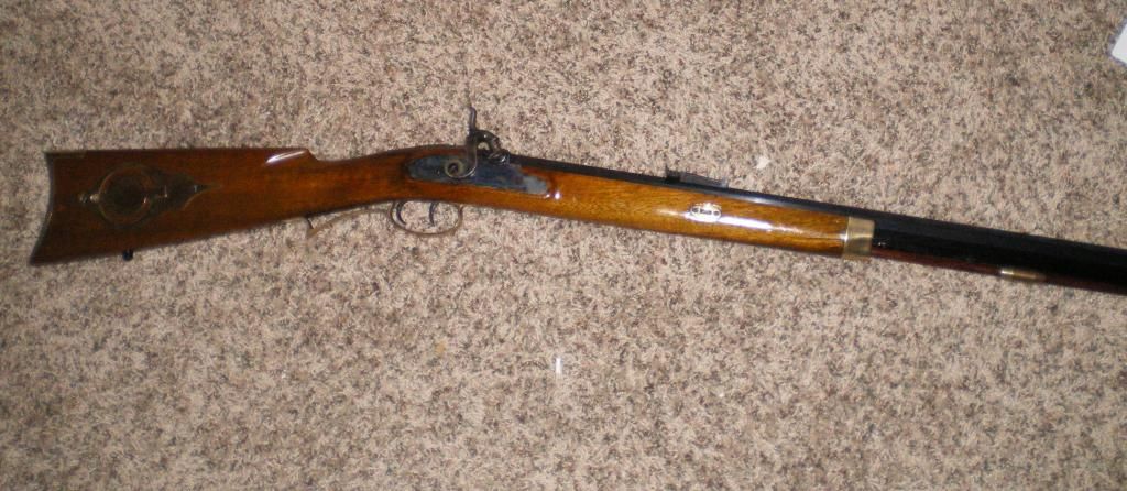

Teach, or any muzzle loader shooter, Just traded for a .50 cal muzzle loaded today, but don't know who made it. No name, made in Italy, just proof marks. Nice wood great fit, pretty patch box. How to find out who made it....

  • TeachTeach Senior Member Posts: 18,429 Senior Member
    There are 3 or 4 major Italian gunmakers who produce virtually all the traditional-appearing smokepoles. Pedersoli is one of the best, but they usually identify their products. Chances are even if the gun carries one of the familiar names like Traditions, Lyman, or a few others, it's a rebadged Italian product. I've owned several no-name percussion guns that shot well. Flintlocks, not so much! I had to totally redesign the flash hole liner setup on my Traditions flinter and reharden the frizzen to make it fire reliably. A good Chambers or Siler lock will cost as much or more than the rest of the rifle if someone chooses to upgrade a balky flint lock. The one in the picture looks like a virtual clone of my first Hawken-style .50 caliber rifle from about 30 years ago. I bought it used for $55.00 and put a lot of venison in the freezer, rust-pitted barrel and all. I used green plastic sabots and 180 grain Hornady .44 caliber pistol bullets in it- - - -the pitted barrel would shred a patch and throw round balls everywhere!

  • JayhawkerJayhawker Moderator Posts: 15,180 Senior Member
    Jerry is spot on....the country was flooded with them after "Jeremiah Johnson" came out. "Italian" can mean a number of things - not all of them good. Only way you're going to know you got a good one is to take it out and shoot it. Have you removed and inspected the lock?
  • Gene LGene L Senior Member Posts: 10,308 Senior Member
    Looks like a kit gun, and there's no way to tell who made it if it's not on the barrel. Hardwood stock, generic hawken design. Could be any maker in Italy. They made some pretty good muzzle loaders. Pietta made a whole bunch.

  • sarg1csarg1c Senior Member Posts: 1,707 Senior Member
    I'll take the lock off today and look it over. If the set trigger will fit my .45 Cal Kentucky, I'll swope them...Thank guys. By the way, can the barrel be counter bored about 1" or could it be a smooth bore? Don't see any riffling at muzzle , looks a little like it hex bored.Is this possible?
    I don't see how it can be hex bored. Maybe has a false muzzle for loading. I also doubt a smoothbore gun would have a set trigger.
    If you're going by the shape of the patchbox- - - -I buy them in bulk as raw castings at muzzleloader shows all the time. That general design is generic to several manufacturers and most of them use the same mass-produced stock furniture. That one sold for less than $150.00 new in the 1980's, and the design hasn't changed at all- - - -the prices just grew.
    Some of the barrels have a short section of smoothbored muzzle to aid in loading. Most of them have 6-groove cut rifling and as long as BP salts haven't eroded big pits in the barrel they're pretty accurate. Let me suggest losing the rear sight and replacing it with a Lyman tang-mounted peep sight. It increases the sight radius by about 6 or 7 inches, and really improves the accuracy. It uses one of the existing tang screws, and only one extra hole needs to be drilled and tapped. Mine will hold about a 2" group at 75 yards with the peep sight and patched round balls. Not target accuracy like the chunk gun, but definitely "minute of deer"!

  • woodsrunnerwoodsrunner Senior Member Posts: 2,725 Senior Member
    Gene is on target about the hex bore. If you can't see rifling in the muzzle the piece has most probably been "coned" by a former owner. Probably not by the manufacturer. Coning a bore is a trick used to make loading easier and faster. Simply ream out the rifling in the muzzle for a couple of inches and it'll load faster. This must be done correctly, however, or it will have a negative effect on accuracy.

  • bullsi1911bullsi1911 Moderator Posts: 9,757 Senior Member
    Teach wrote: »
    Yep.. Here is that same patchbox on a current flintlock kit:
    http://www.dixiegunworks.com/product_info.php?cPath=22_162_193&products_id=3492
  • HAWKENHAWKEN Senior Member Posts: 1,688 Senior Member
    Gene was right, it is a kit gun. I have the identical gun, in .50 caliber, purchased from Walmart, in the 70's for $100.00. The stock was partially inletted and the brass parts were sand castings. I cold blued the barrel, using 44-40 liquid bluing, and finished the stock with 30 coats of hand rubbed linseed oil. That was a real PITA. I polished the mating surfaces of the lock, and double set triggers to a mirror finish. I had a black powder gunsmith make me a set of full buckhorn rear sights. This gun is a shooter and I brought it to the 2012 SE shoot. There are no markings on the gun to indicate who made it and I long ago lost the book that came with it. If I can help you with anything, you have but to ask........Robin
    Teach wrote: »
    Not going by patch box cover, going by the proof marks and a call to Cabel's, also by the fact that the locks uses coil springs like Cabela's stated. Made by Pedersoli which don't use their name, just a trademark except on ocasion
    olesniper wrote: »
    The Cabela's Hawkens were made by Investarms, in Italy.
    Not according to Cabela's Pedersoli and a couple more made their Hawkens, they sent me a list but pedersoli was the one with coil springs.
    Almost all of them now have coil springs. I've owned several Pedersoli BP rifles and they were all marked Davide Pedersoli. Proof marks are not done at the factory but at a proof house, so there's no clue as to who made it from the proof marks, only what country it was proofed in. Also, all Pedersoli rifles I've owned had European walnut stocks. My Lyman Plains rifle which is marked but I can't remember by whom also has a walnut stock. It doesn't have a patch box and has steel furniture.
    Also, that's not a $450 rifle. And it's not a Cabela's as it has a hardwood stock.
