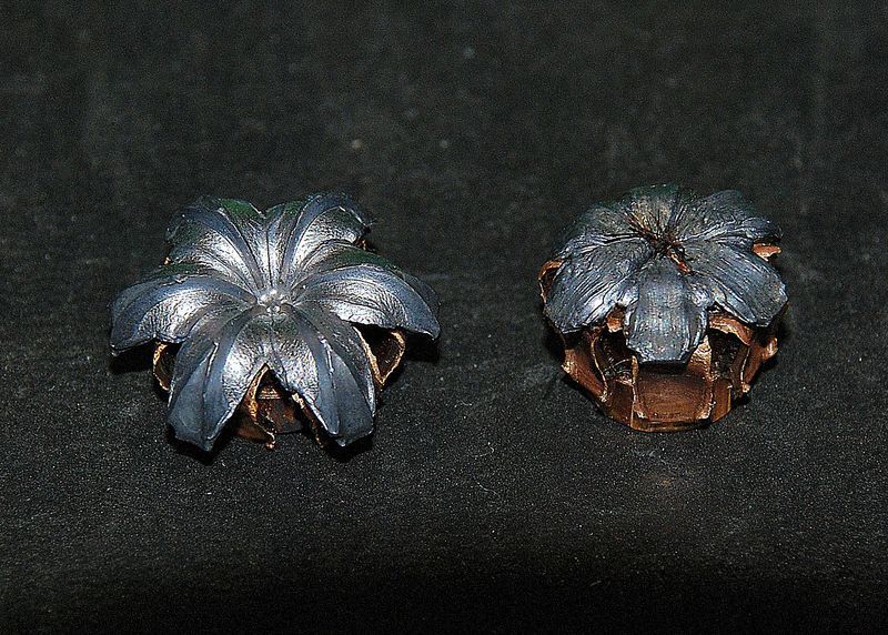

Are you sticking with the load you shot the pig with?
Yes.
Full Penetration but not Over Penetration
Adequate Expansion
100% Weight Retention
What's not to love?

Left is from Water Test & Right is from the Pig
Both retained 100% of their weight but the water bullet expanded more.
