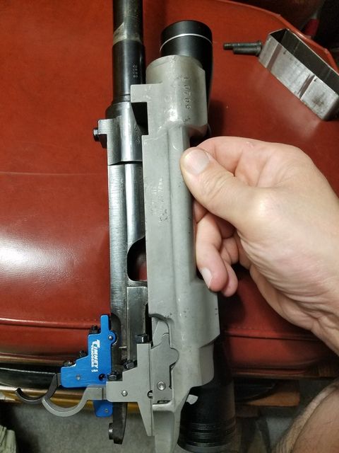

  • Johnny rebJohnny reb Member Posts: 715 Senior Member
    What are the bolt face dimensions?
  • MileHighShooterMileHighShooter Senior Member Posts: 4,975 Senior Member
    Johnny reb wrote: »
    .540 but the bolt body and gave have enough meat to open it up more

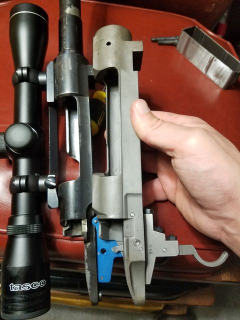

  • snake284snake284 Senior Member Posts: 22,429 Senior Member
    A HUGE hunk of that is the Boyd's stock. They make a great stock but those suckers are HEAVY!!!! You can reduce the weight substantially by going to a ultralight contour and either a synthetic or a sporter stock and remove a ton of wood off it and go for aluminum rings. You can also get aluminum bottom metal or make it into a blind magazine gun and easily get down to the 7 lb range.
    I remember Calebib had pics of one of the Mauser's he built with a Boyd's stock. He took a good bit of wood off of it and it looked fantastic. That guy is good!

    Couple more pics.
    Lots of room to open up
    Here is how much space is left. These are 375 H&H. That's 5 rounds down. It ALMOST fits 6 down
  • BigslugBigslug Senior Member Posts: 9,326 Senior Member
    No clue! But these actions don't pop up very often, and especially not with a 3pos safety already installed, and not for what I paid. Price was right, so that was the easy part. I have ammo/dies/barrel for the H&H, but seeing how big this action is, seems like there is a lot more potential.
    The next question becomes "Potential for what?"
    I scored a CZ .416 Rigby years ago in one of those "know the rep" deals I couldn't walk away from. The challenge is not loading it up, but finding the right powder for safely loading the huge case volume DOWN. Got it rocking a 350 grain gas check at about 1800-1900 fps, and I can't conceive of much that wouldn't floor. As for 400 grains at the full-tilt 2400 fps. . .physical damage to self becomes a real possibility. Like base-of-skull headache, stretching of optic-nerve stuff. I pulled the bullets on those early handloads rather than continue shoot them. Good for what it was designed for, but not without its down side.
    I'm kinda in the same boat as you. Got a P14 Enfield (big action) that's in the process of turning into what will probably be a 10# (ish) .375 H&H in the classic Safari pattern. While I could go a lot bigger in the round department the decision was based on (1.) REALLY liking the Enfield mechanism, and (2.) wanting a big round with a lot of versatility that could be shot a lot rather than living with novelty "safe cannon" status. Some of the charge-stopping calibers can be downloaded easier than a .416, but it's worth it to know going in that it's really hard to plink effectively with a Rigby.
    Here it is next to my FN M98

    Your CZ and my BBK-02 are basically the same action.
    I do want a 375 H&H, but I think I'd rather have it a bit more trim. Still a strong possibility. I think a Mod 70 or Zastava would be more up my alley. I have a 376 Steyr and 9.3x62 in the fire as well, lots of overlap. But those will be walnut & blue.
    Downloading the Rigby does seem like a pain, that's a BIG honkin case. But tempting. Expensive as heck though.
    Waiting to hear back from Caleb to see how feels about the Ruger MKii 375 conversion. If that seems doable, than the 458 is out on the 77, and this 98 can go wherever. Probably best to stick with the basic belted case, but that opens up
