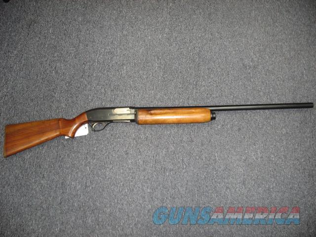

    It's a High Standard C100.
    See the source image
    Not a lot of info out there, but I'll keep looking!
